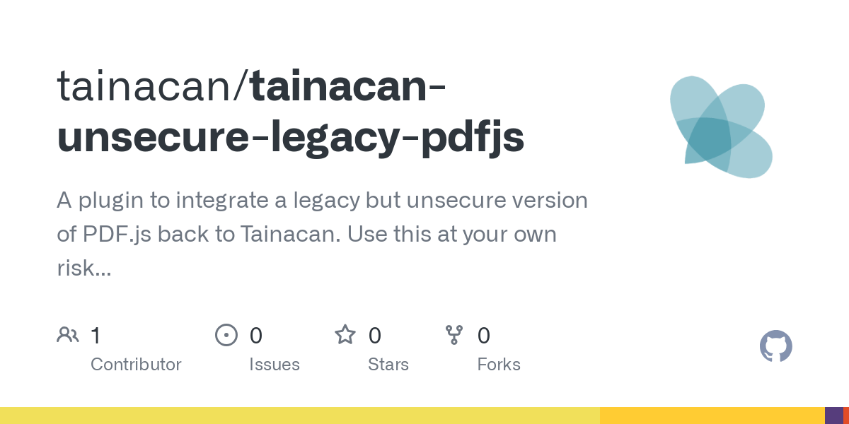

Uhm… I can see if I create a plugin that brings back that functionality but then we would not send it to the WordPress directory plugin due to its lack of security :thinking:
After a bit of discussion here around this, we agreed to create a plugin that brings back this functionality. Just keep in mind that it will bring back the security flaw:
https://github.com/tainacan/tainacan-unsecure-legacy-pdfjs/releases/download/v1.0.0/tainacan-unsecure-legacy-pdfjs.zip
After another update from your end on Wordpress directory, this will be unusable?
Sure, this is not a replacement of the Tainacan plugin, it is a complementary plugin. It just adds this extra functionality. You will keep receiving updates from the core plugin via the WordPress directory.
It seems that doesnt work correctly. It shows the PDF viewer but doesn’t shows the document itself. I have to rollback to 0.21.5 anyways. If you have any update on this subject, pleas elet me know.
This is likely some other configuration that we would need to adjust on it, can you give more details?
I would advice strongly against keeping an outdated version. We’re doing an effort here to offer the feature externally via plugin because using an old version will keep you out of bug fixes, security updates and will likely cause compatibility issues with WordPress and themes in the feature. Let’s see what is the cause of your issue first.
