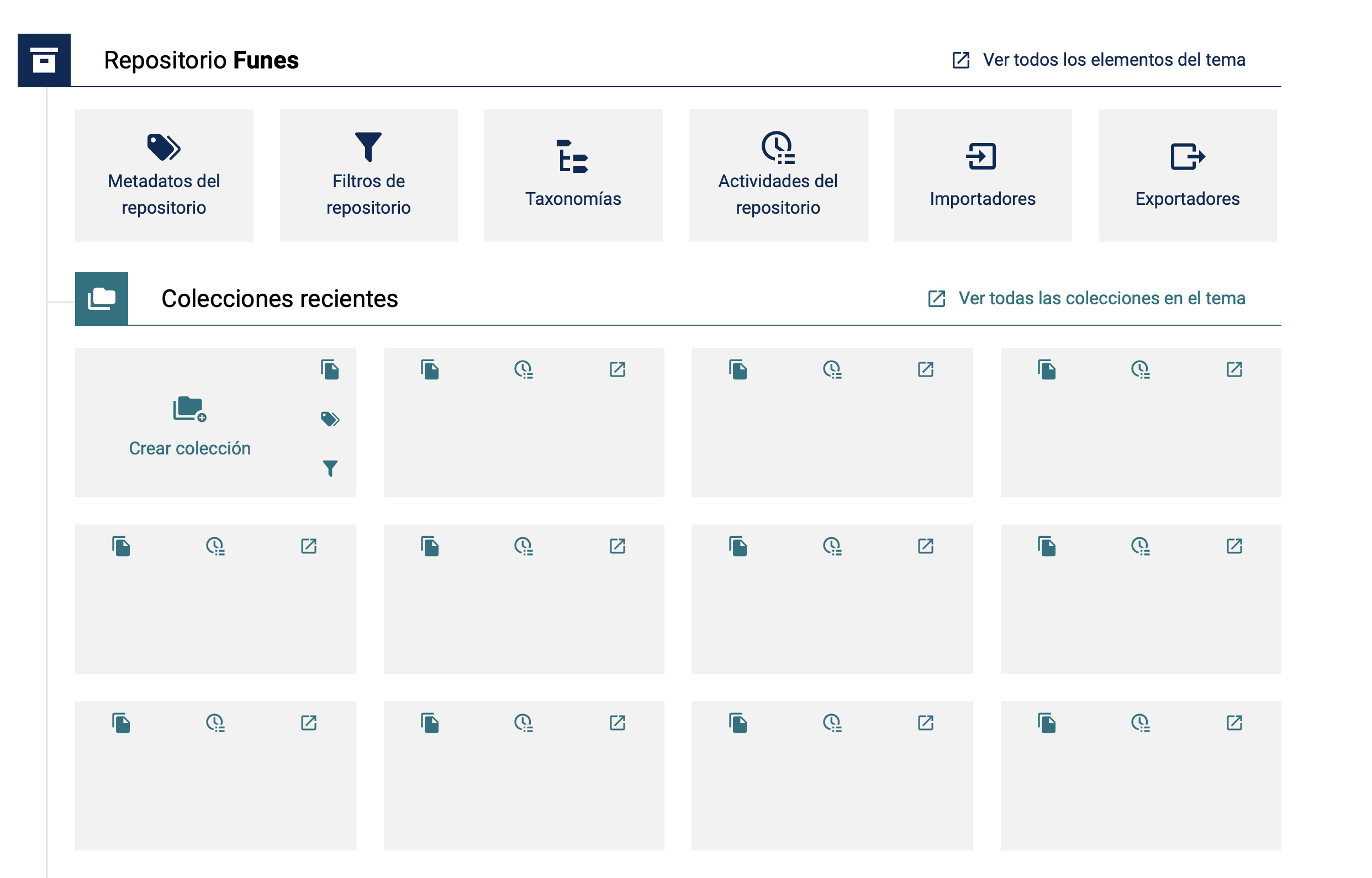

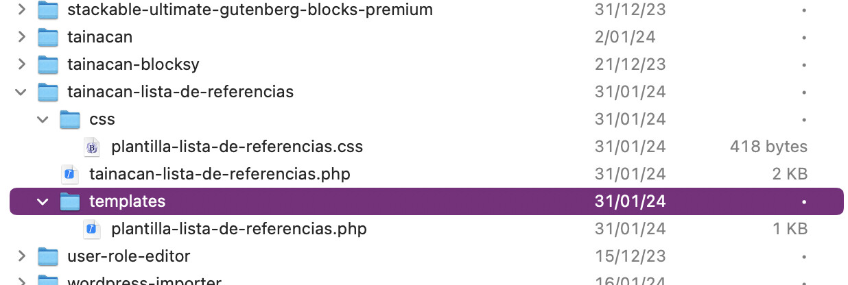

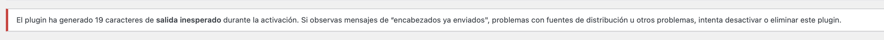

My technical knowledge is not the best and I will understand if this question remains unanswered. I am trying to create a new view with the template schema. I am trying to follow the instructions from here: Tainacan Wiki. When I activate the plugin I get the error “Plugin generated 19 unexpected output characters during activation” (see picture 1). After activation, tainacan backend looks as in picture 2. In picture 3, the structure of the plugin in the plugins folder can be seen. I am attaching the two php files and the css file, in case someone can tell me what I am doing wrong. I thank you in advance.

Hi @argeifontesfunes!
As you might have guessed, the Extra View Modes plugin is one good reference for starting building this. The issue that you are facing is caused by a fatal error on your tainacan-lista-de-referencias.php file. Please remove completely this line:
?> /* End of file */
And the problem should be solved :smiley:
If you have any other doubts on building the view mode, don’t worry about asking it here. This is a territory that few have explored and we would love to hear your feedback!

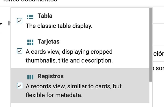

I do not know why I do not see it. See pictures.
Best regards,
                    Pedro

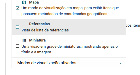

After many difficulties due to my scarce technical knowledge, I was able to downgrade to php 7.4, but the view does not appear in the view modes available in the collection settings. Anything else that I can look for?
Best regards,
                    Pedro
I am sorry to flood this chat. It is a problem with the specific collection. I created a new collection with preset Dublin core and the view appeared. What can be the problem with my collection? What should I look for?
