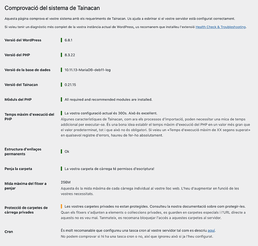

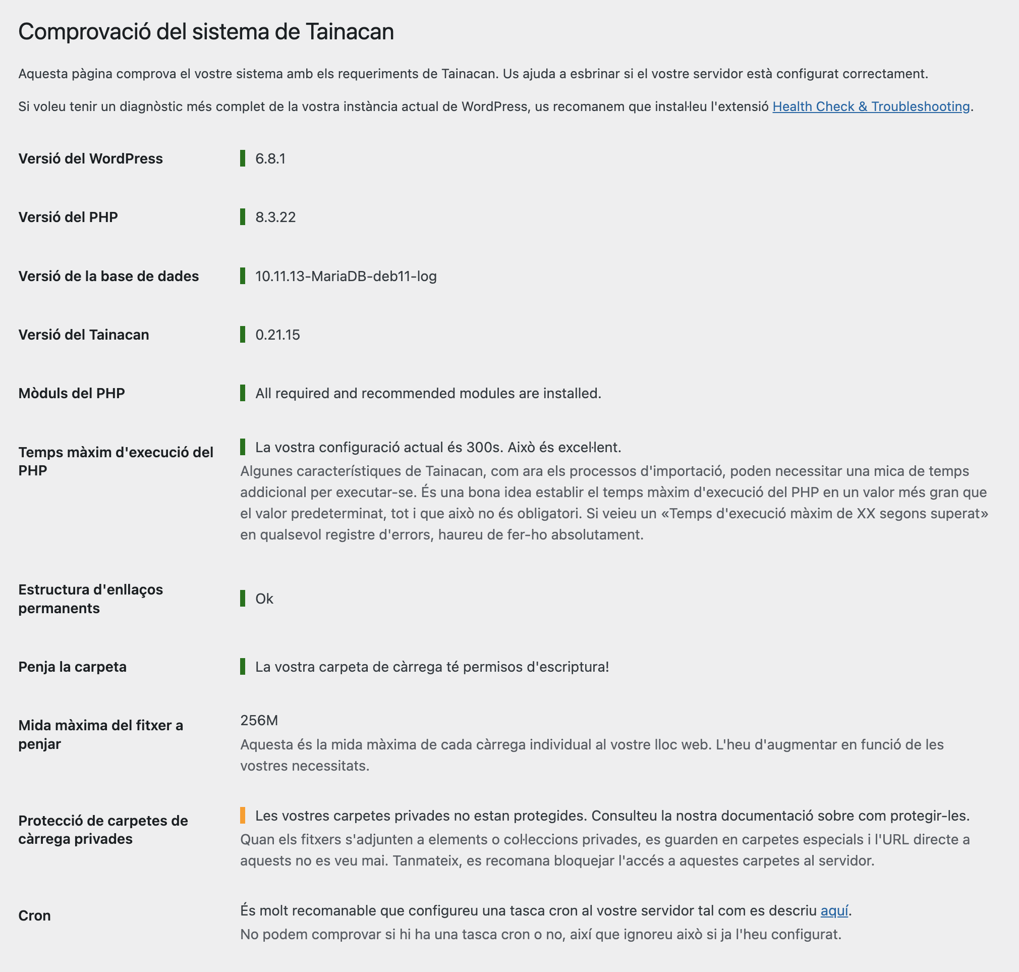

I’ve also attached a screenshot of my Tainacan → System Diagnostics page.
